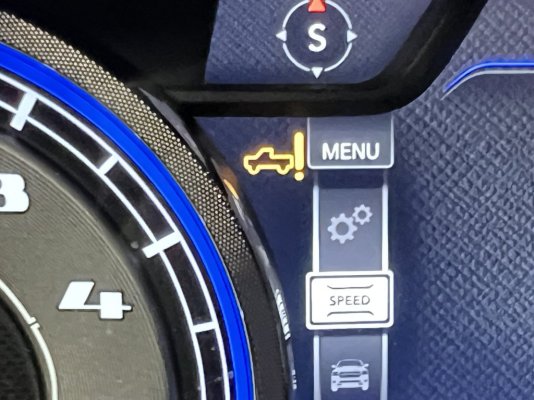

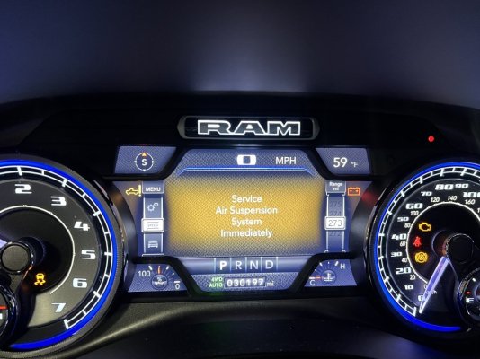

Well folks, here we go again! Truck died again. Same issue! I took yet another video and pictures of the dash lights. So, tomorrow morning they will be getting a call from me. I can’t imagine that this is good for a new battery. This will be the third recharge after it is drained.

That's most unfortunate but not too surprising.
I would urge you to never return to that dealer, find another local mechanic that has good reviews, or find a helpful friend and get help here on the forum, if you have the time.
That dealership sounds very incompetent, will just keep taking your money, and may never get this fault repaired.
If the noise has returned while the key is off, start pulling the fuses we identified earlier. Once the noise quits from a fuse extraction, you will learn what component is eating batteries.
Leave the fuse out and get a low-current (2 Amp) battery minder/charger onto the battery before it expires.

I didn’t think it would be that hard either. You would think my video and me showing the mechanic would give him a lead to what is going on!

My 2020 RAM would not start. Nov. 27, 1023 I put in a new battery. On Dec. 14,2023 my truck wouldn’t start. When I looked under the hood I could hear something running. It would alternate between a high pitched noise and a sshhhhhh noise. I did video the issue.
It has been at the dealership for weeks. Still no solution. Any help is appreciated.
Do you have the air adjustable suspension. Sounds a lot like the compressor kicking in.

Yes I do.
FYI- I picked up my truck. The serviceman told me that the new battery had a bad cell. Well, I did tell them when I had it towed there that it was a new battery and I had contacted NAPA in case they needed to replace it. I was told by the serviceman that it is unlikely it is the battery, it’s new. I told them to check the battery. After repeated charging it continued to test low after a few days. So they replaced the battery under my battery warranty. We shall see if that does the trick. PS. They did not charge me for labor for the second time it was in there.
