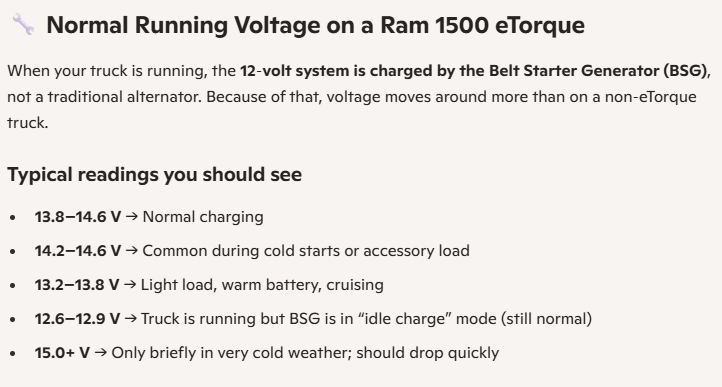

According to Google:
**A voltage reading of around 13 volts is typical for the eTorque system in Dodge Ram trucks**, as it primarily charges the 48-volt battery and indirectly supports the 12-volt system. Fluctuations in voltage are common and generally considered normal for this hybrid system.
For a fully charged healthy battery. It varies...
