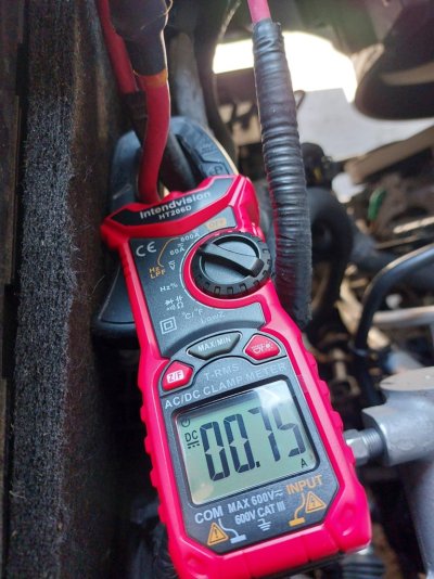

It's sounds like you both would benefit from buying a DC Clamp meter.
You could prove if there is or isn't a parasitic draw. $29 is a great deal for this meter.
