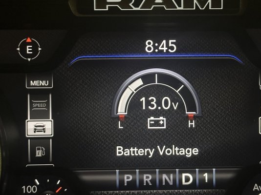

My truck sat for 5 days while I was out of town. This evening the battery was completely dead.
I tried jumping it with my wife’s car, but the engine wouldn’t crank
I let her car charge my battery for 10 minutes and the truck finally turned over.
But I now have a Check Engine Light. The voltage is showing as 13 volts. I drove the truck around a little, turned it off and let it sit for 30 minutes.
The truck fired up again, but I still have the CEL. The voltage starts somewhere in the mid 12s, it increases to 13.6, then drops to 13.
The 12v battery was replaced less than 6 months ago.
Any ideas?

Put the battery on a battery charger overnight,and see if anything changes.The truck won't actually charge up a dead battery,it'll only maintain it,you need to use a battery charger to bring the battery back up.

I just started the truck after sitting overnight. It was a little hesitant, but it started. The voltage was at 13.8 volts at idle. Not sure what that means though.
The alternator will absolutely charge a dead battery. If it didn't then the battery would die after a few months of starting because it was only "maintaining" it.
It sounds like the battery might be going bad. 5 years is a little young, but not unheard of.

My buddy stopped by earlier with his battery charger. The charger said the battery was at 17%.
Battery has been charging for 7 hours or so and it’s currently at 70%.
I’m hoping this was just a fluke and I have no more issues once it’s charged.
Do you have any idea of the voltage level when you started charging?

I’ve never used this charger before, so I may be wrong about what it’s telling me. But when I first connected it to the battery, it said 12 volts.
If all it read was 12 volts,you basically have a dead battery,a good battery should read between 12.6 to 13.2 volts. There's 6 cells in a 12 volt battery and each cell when fully charged should be between 2.1 and 2.2 volts.
I'm to lazy tonight to dig up a battery chart for you,but at 12 volts you're battery is pretty well dead
