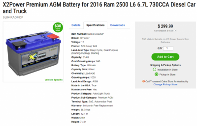

Anyone have any experience with this battery or brand? The 60 month replacement warranty is attractive. Most batteries only have 36 months anymore. It's spendy, but so is the Optima.

I decided to go with the Northstar X2 AGM dual purpose (starting and deep cycle) because they are a true 94R fitment, exceed the CCA rating of the factory batteries, and there is currently a 20% off coupon through Batteries Plus, and $30 mail in rebates (for up to two). That brings the price of the batteries down by $180 for the pair (basically they're $209 plus tax instead of $299). They also have a 60 month replacement warranty, and I read many good things about Northstar.
I put these in last year. So far so good. I also purchased because of the warranty.
