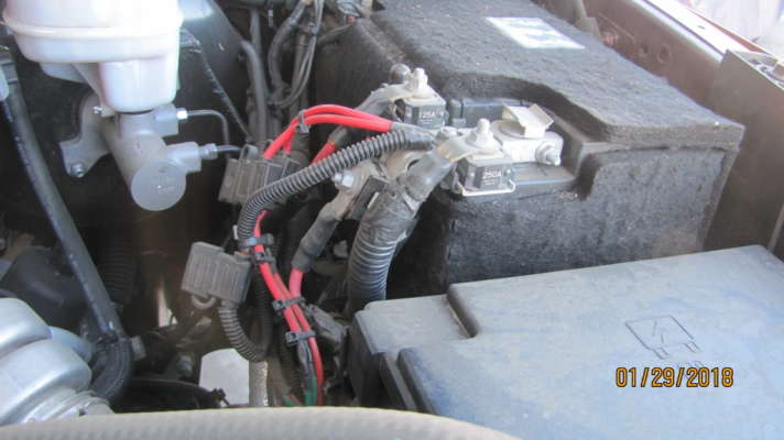

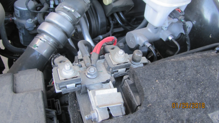

What is the 'battery restore fuse " for...in the fuse box? Does it reset the charging system after a battery replacement?

From a Google search:
A "Ram 1500 battery restore fuse" refers to the main fuse located at the positive battery terminal of a Ram 1500 truck, which is designed to protect the electrical system from excessive current draw and needs to be replaced if the battery is completely dead or if the electrical system experiences a significant overload; typically, this fuse is a high amperage type, usually around 100-200 amps depending on the model year.
Key points about the Ram 1500 battery restore fuse:
  • Location:
    You'll find this fuse on the positive battery terminal, usually secured within a plastic housing.
  • Function:
    It acts as a safety mechanism to prevent damage to the electrical system in case of a short circuit or extreme current draw.
  • Replacing the fuse:
    If your Ram 1500 is experiencing electrical issues after a battery replacement or a significant electrical event, check the battery fuse and replace it if it's blown (visibly damaged or melted).

If your truck still starts the fuse is good,if it blows the truck should be dead and even a boost won't get it running.

IMO that fuse is to protect from someone hooking up jump box or cables backwards. More than anything else
