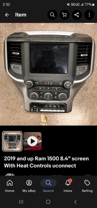

I have a chance to get a 2019 ram classic 8.4 uconnect with bezel at work. I have a 2018 with a stock 5.
# 1. The connector looks the same, will it work?
#2 does the 2019 have android auto. That would be the main reason to get it.
Thanks
Thanks
It will work and all 2018+ 8.4s have Android Auto and Carplay BUT you will need more parts. It looks like you have a 2018 truck so you may not need a new USB hub in the center console. You will need an 8.4" HVAC Module and the conversion harness which is sold by a forum member and vendor (@Mpgrimm2 ) here:
You can contact Mpgrimm2 prior to purchase and give him the details of your setup and parts on hand to find out exactly what you will need.

Guess that 2019 radio won't work without a bunch of different stuff. I'll end up keeping my Kenwood

If your Ram came with a 5" radio ..
You likely would need a minimum of a BEZEL for the 2018 8.4 unit
this company over charges, you can get it much cheaper elsewhere
look at this place

But having a 2019 radio, I need the bezel and radio. Cheaper to keep the Kenwood. It has android auto already.
By my read, you only need two more things, an HVAC module and a 8.4 HVAC harness. What other parts do you think you need?

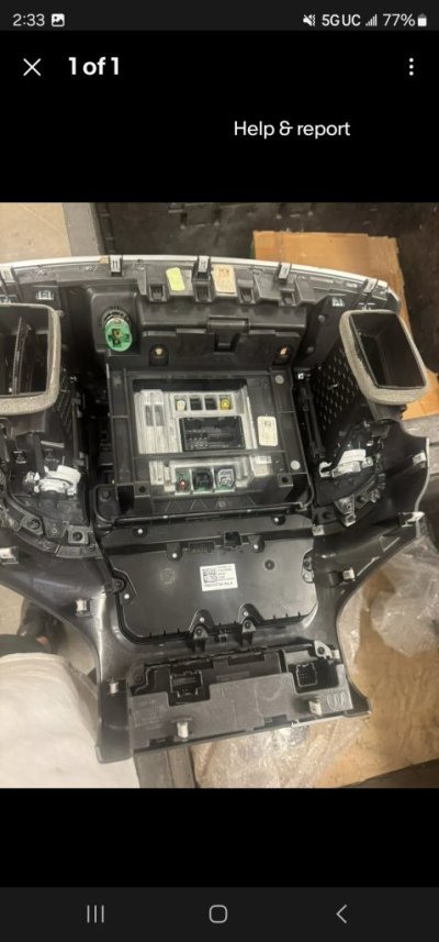

I guess the radio is from a Gen 5 8.4. I thought those had just a face plate and separate "radio guts" but the one I got looked like mine (Gen4)

Well, the radio works just fine in the truck, just no Android auto. The media hub is working so I can use my music apps I just need to figure out if Im selling the whole thing, Keeping my Kenwood, of getting the android auto interface and use the 8.4 from the 2019.
