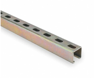

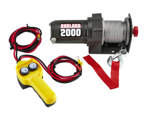

Don't know how much weight you are thinking, but since i see a ladder rack
Uni/Super/Flex strut
Trolleys
atv winch

Would likely be a maximum of maybe 1,300 LBS, nothing too crazy. Would the strut be mounted through to the frame with the winch on it? Not sure how I would mount it to the frame except for possibly some U-bolts, haven't had much luck with any having done it with some documentation so I could get myself through it.

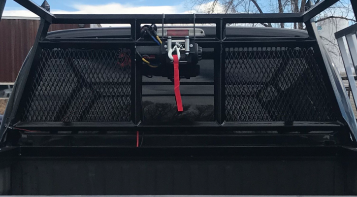

You see frame mounted headache racks with winches on them all the time here in the oil patch. Winches are mounted near the top so you can gin pole with it or run it through a ****** block on the bottom to pull stuff into the bed.
