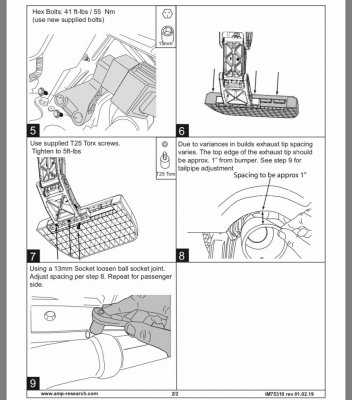

Anyone here installed the Amp bed step on a dual exhaust truck that has 5" tips on it??? I saw one thread where someone thought you couldn't but I've seen another one that says it's possible....

As long as your 5” tips are 1/2” from the bumper cutout it should fit no interference.

Just to update in case anyone else asks this question. I installed a Bestep bed step with my 5” Moes exhaust tips and there is plenty of room.

I have the bestop bed step with 5" carven exhaust tips no issue at all. The step has a decent amount of position adjustment
