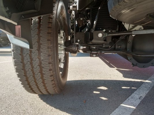

So this is what I think I am seeing:
- 2024
- Single rear wheel
- megacab
- White - which is not what I would normally buy at all, but it is hot here.. ( normally would buy silver ish color )
- Limited model and the sales guy said it was loaded with everything
- The sun was so bright I could not really read the window sticker
- I should have looked more closely, but I am not sure if it was a 2500 or 3500
- 4wd
- air bag suspension in the rear, coils in the front.
Nearby was a full size bed laramie
- Normal dual cab style
- very beefy leaf springs

A few pics.
Thanks for any insights / comments.

RAM's rear air leveling system isn't for your back, it is to level the truck when loaded. The 2500 rides much nicer (I think the pictures in your original post show a 2500) than a 3500 which has rear leafs even if the truck has the rear air leveling system. If you want a better ride, look at GM's HDs with IFS, Ford and RAM HDs use solid front axles.
