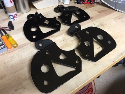

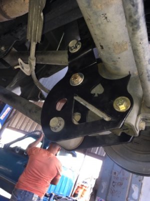

While your doing 90 hit a big bump or dip in the road and then see what happens. Mine did it a few weeks ago doing 90 heading to Fresno on Hwy 99, thought I was going to loose it. Scared the crap out of my son and I. The crazy part is that I have the rear relocation kit here that will solve the problem but I can find no one in Nor Cal that is willing to install it.

is that the cut version or no cut version? how much are you lowered? weird that no one is willing to install it
circuitguy
Aug 10, 2018
1,930
1,562
Elk Grove, CA
2017 Ram Tradesman Regular Cab
5.7L HEMI
Its the cut kit. I am a 2/4 now but am going down to a 3/6 when this cut kit is installed. I checked with a half dozen shops and no one is willing to do the work. Five years ago I would be able to do all myself but no longer able to get up and down on the ground like whats needed. I might have to take a trip to Southern Cal to get this done. If you know anyone around Northern CA that can help please let me know.
