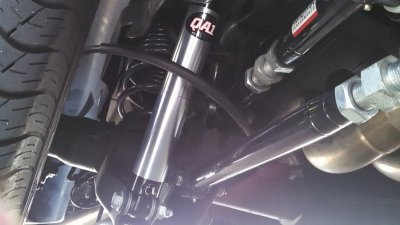

I have 4 Belltech Street Performance shocks in my garage... they have about 1,000 miles on them. :hmm:

What are you using with your kit?
I'm trying not to go to crazy yet as I financed a year on this truck to help rebuild my credit. As soon as next Christmas gets hear and I make that 12th and final payment, If I still have a lot of interest in it I'm gonna supercharge it and work on getting the power to the ground.
I have the QA1 shocks.
