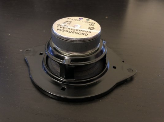

When I found out that there are supposedly speakers hiding in the dash, I had to pull the grill off to make sure. And I found something.
This is how this embarrassing pile of crap looks like.

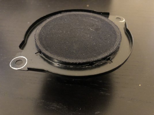

There is a cheap paper cone lurking inside. I think they had to cover it up to protect it from disgusted looks. Tiny magnet and this thing weights nothing.
