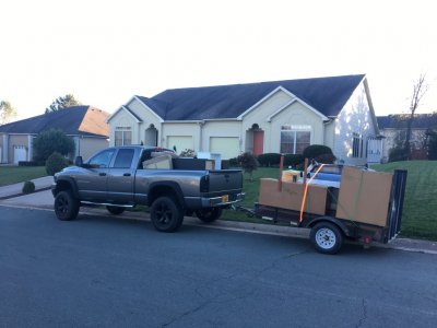

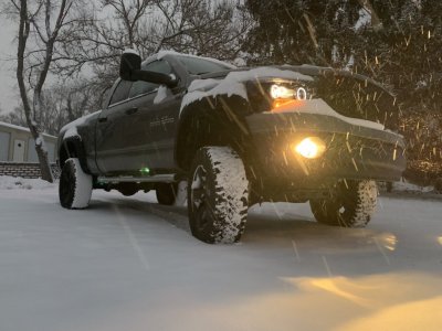

I've been running a Rough Country 6 inch lift for about 6 months now and I'm thinking its about time to reinforce my front end a little more since I have 22x14s with 37s on the way. I'm thinking getting heavy duty Upper control arms are probably #1 on the priority list, with fresh ball joints and all that. Any other suggestions? Thanks
(Just some random pics of her for fun)
