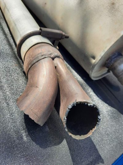

Veraram intake or CAI, 3.92 gears, headers, muffler and resonator delete. "This woke my truck up" Or a good aftermarket muffler. handheld tuner, or custom tune, cam, I would venture and say probably the E fan mod as it will have no drag on the engine. Pedal commander for better pedal control. That would be my list right off hand.

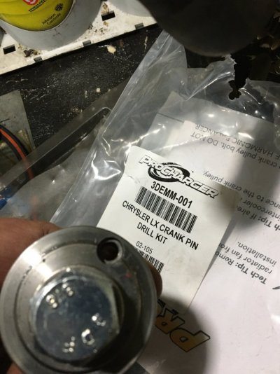

We are talking about trucks weighing 6-9k right. Just blow some air at about 8 lbs an have fun.I’m sure even that will fry the 8 hp70 eventuall. The loud exhaust is ok but unless you have a 2 chamber muffler with mild to wild, eventually it will grow old. The S/C is fun to hear,never heard anything but the blowoff valve with loud exhaust.The 5.7 needs true dual exhaust,agree. As soon as I get over the rise in header prices.AA5412CC-0FEB-4008-AC0F-2D852FB6FD4C.jpeg
