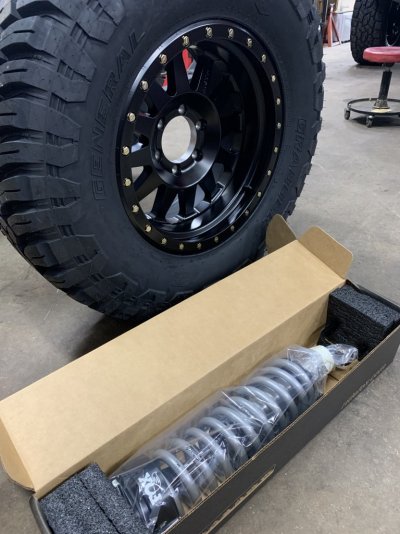

That is a great option @Nick@GotExhaust can get you set up with a pair. I just put a set on. They would be considered an upgrade as they ride way better than stock. We just did this combo and IMO it’s one of the best combos for the 5th gens. Fox 2.0 coil over. 18x9 -12 wheels and optional 35x12.5 with very minimal plastic trimming. A 33x12.5 would not need any trimming
