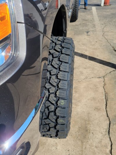

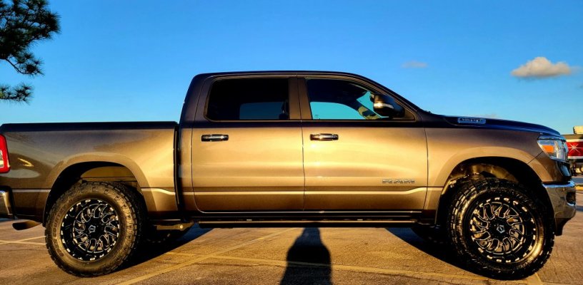

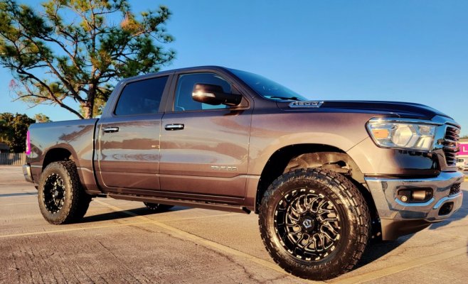

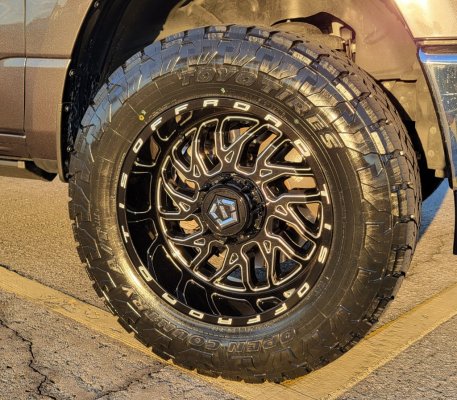

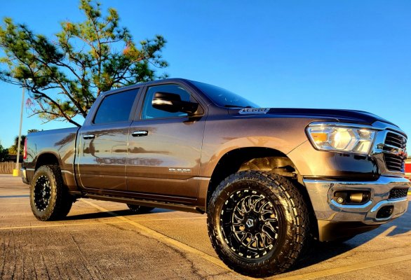

Just wanted to share my experience. I started out with Foz 2.0 Leveling coil overs and Nitto Recon Grappler 295 60 20
After month riding around I wasn't happy with the look.
I had SUV's pulling up next to me sitting higher
I pulled out the Fox coil overs and installed the Maxtrac Spindle 4" lift on my 2WD 5th gen 6 cyl
I did the install myself in my garage , front took about 4 hours and the rear took about a hour with a rental tool to compress the rear springs. Whole kit was very easy to install.
The ride quality is excellent with the Spindle lift.
I Sold the new Nitto's 295 60 20 and bought a new set of Toyo AT3's 35x12.50R20
I has them mounted on new TIS 544BM 20x10 -25 offset
I love the look now, love the ride quality, the UCA angles havnt changed using the Spindle lift. I did use 1-1/2" spacers the kit came with for the rear
I started out stock at 36-1/2" front fenders and 38" in the rear
With the lift I'm sitting at 42" front to rear . I belive the rear is 1/4" lower if I remember when I took the measurements.
I really wanted to go with 22's on a 35" tire setup, but I got a sweet deal on the TIS rims on FB market place NiB I paid $1,200 so it was hard to pass up.
Over all I'm really happy with the look and the ride!
The paint is that metallic gun metal grey, but I took the pictures when the sun was setting and the sky was orange so it through the color off on the photos :)
