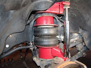

Do not get entry level Bilsteins if you don't like a rough ride. I think you are in a bad spot, because if you go for comfort I doubt you will like the way your truck will respond especially around corners with those 37's. I might look at getting some type of air bag for your front coil to soften the ride or remove the coil all together and go with a dual bag setup, and stay with firm shocks. I think most of these are for a solid axle, but I would search for something like this. You also will be able to find these for your back for sure. I had your generation truck a long time I ago but I forgot the front suspension setup, and it was a 2500 anyhow. This is the direction I would go though, maybe do the back first because you can find those for sure, and see if it helps.
An air bag and a coil will do the same function, so another option is to find a softer spring. The difference is you can adjust an bag at will, but your stuck with the coil. I would try to find a bag for the front, if not possible I would get a softer coil, but don't get softer shocks, this you would regret.

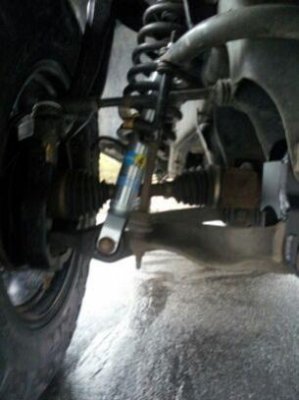

I went with bilsteins all around. they ride really nice for a lifted truck
