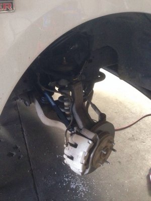

I have a 2wd 2013 ram and learned the hard way what happens to the 13-14 rams when you put a leveling kit on it. So my upper control arms ball joints popped and cracked my
Upper control arm offroading. My current setup is maxxtrac 4.5" spindles, 2.5" daystar coil spacer, icon uniball upper arms, limit
Straps up front, and 3" maxxtrac rear coil springs. Now I want to have the best ride quality while offroading. So should I remove the coil spacer and get new stock length shocks(14" I believe)? Or should I leave the coil
Spacer and get new extended shocks(approximately 17" ) I'm not jumping my truck, I am romping it sometimes tho, when I go shooting or go to big bear I hit the trails. I just want to know what will be more beneficial in your guys opinion. I want to run a high end shock, king, fox, bilstein. I currently have pro comp 3000 up Front

Nope haha all the 13-14 rams have that issue. There's a few threads on it. I personally
Went with icon but a lot
Of members are buying zone upper arms

Better than what I got them for ! I got mine for $750 from icon directly. That are very nice arms you'll like them ImageUploadedByTapatalk1401076479.085765.jpg
