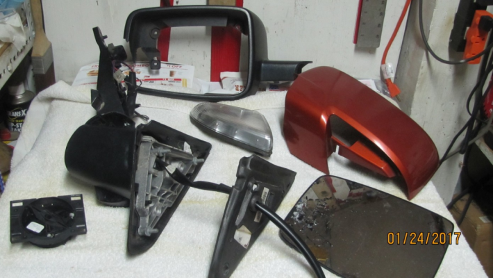

Go to the Dealerships Parts Dept. & you can buy the mirror glass there
You can disassemble the mirror & between what is available at the dealership & wrecking yard donor vehicles, you can build a replacement

Take a pix if you did not repair the damages mirror
In fact, take a pix of the mirror anyway

Thanks my mirror is much different than yours.... But I followed your advice and pulled the mirror glass off mine... I clearly see how to take the outer back cover off and replace the turn signal... Been busy... Death in the family... But I know I can replace it..

Thanks And I got to it this morning.... Took me like 15 minutes in a drizzling rain.....
