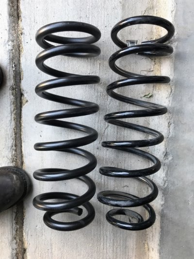

Were your springs shorter than the OEM, when installed?
AFMoulton
Apr 1, 2016
3,178
5,196
Nuevo Mexico
The didn’t look shorter but maybe by a little bit, the Bils definitely had about 1-2” more travel than the stock shocks

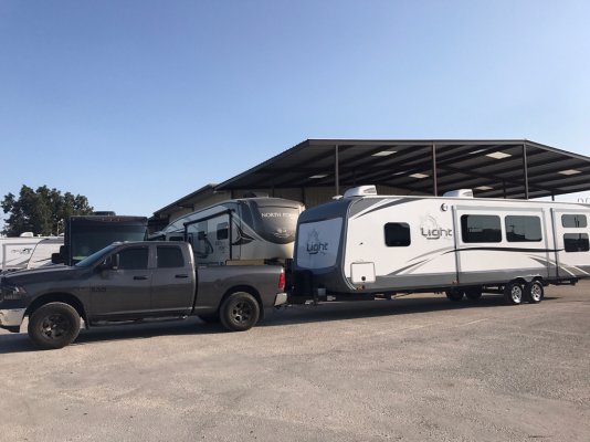

Bilstein 5100 & TufTruck TTC-1211
I set my Bils at 2.8 and I don’t have a huge problem when loaded up.
This is prior to adjusting the load in my trailer.
And my WD hitch.
D

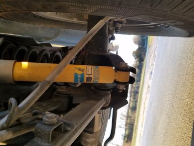

Interesting, are you sure those are 5100? The ones on my last truck and the ones I am about to grab for this one are both silver.
