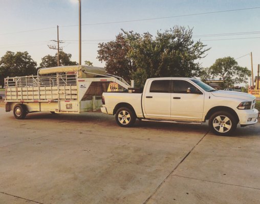

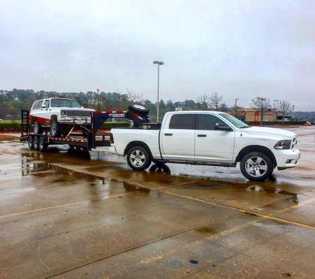

The 1211's add 50% capacity and don't lift, the 1223's add 50% capacity and will lift the truck about 1.5"-2" unloaded.
I can vouch for the 1223's. I have them on my truck with my bilsteins at 2.8" and I never sag below level and when unloaded I have just a slight bit of rake, measures about 1". But I constantly have about 400 pounds in the bed; toolbox/tools, B&W hitch, etc. I've pulled a 30' car hauler with a blazer on it as well as a very heavy 24' big bend stock trailer with horses in it. Best mod I've done to my truck.
ddbc489ed62ec1fe1e154916057e83e9.jpg Unloaded
684bf36061aa7dc0293e925cbe80d991.jpg16' stock trailer empty
1addfb2e756366a46bf8a4a383585099.jpg 30' car hauler and blazer
