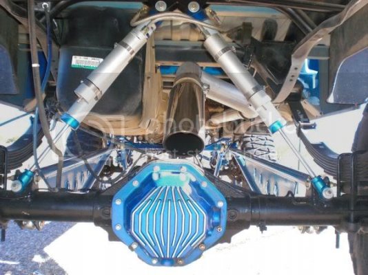

haha, stock on this site?
Dan you should go with something like this :)
I'd love to run a full Fox or King set up. They are expensive though.
