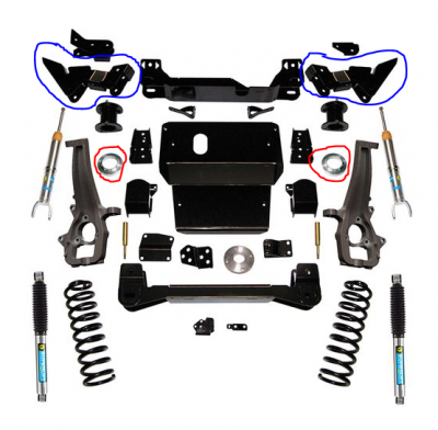

For reference, in the pic below my 4” kit came with everything shown EXCEPT the 2 spacers circled in red. Those spacers are what go in the factory coil to generate the additional 2” on the 6” kit. That is all you WOULD NOT USE if you wanted only 4”. The rear relocation brackets (circled in blue) used to come with the 4” kit (the one I have). These are why you would want to spend the extra $100 for the 6” kit over the 4”.
Check out the part numbers between the 6” and 4”, they are the same! IF you decide to go the Superlift route, do yourself a favor and get the 6” kit........I’d go that route all day everyday and twice on Sunday before worrying about the nicer shocks.
