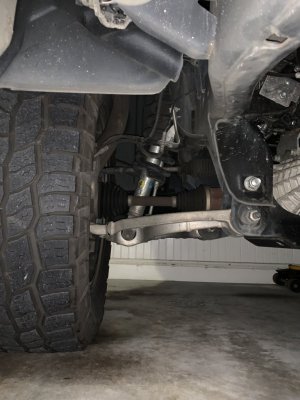

My 2014 don’t look like that........my Bils are @ .7 which is nothing.
that’s all it takes, mine is at 5” which is 1” over and mine are perfectly flat
If i set my Bils to stock they’d be flat, not inverted. Mine look almost flat but they are ever so slightly beyond parallel.
pics for reference
