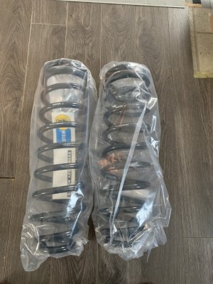

Hi guys,
I was wondering if anyone has some feedback on these coil springs. I am interested in buying them to gain 1” of lift in the rear. I was curious in what way would affect the ride. I don’t want to make the truck to stiff or harsh. Thank you.

I think I've only ever seen one person who had them and talked about it here on the forum.. can't remember their username or what they said though :(
From the product photos they appear to be linear rate springs rather than progressive and they're not marketed as cargo/HD springs - that suggests they're likely going to ride pretty similar to stock, but they're a little longer both to provide lift and to avoid falling out when RCSB owners use them with Bilstein 5100 "0-1"" shocks in back.

I have them and they're the farthest thing from stiff or harsh. As a matter of fact they re buttery soft. They re a little longer than stock, but under my Crew Cab Short bed only gained me about a half inch of lift with my heavy toolbox. That's not a bad thing per se, just don't expect a lot of height. They aren't great for hauling weight around constantly though as mentioned. After about 50k I've had zero issues, and I wouldn't hesitate to continue running them.

Haven't posted or been on in forever, but I have them as well. Not the best for doing truck things with, but off road they're quite nice.

I have the bilstein rear springs, I'm taking them off because I'm putting on a Zone lift at the end of next month. I only have about 5,000 miles on them, and have enjoyed them. They aren't super stiff, but haven't noticed them being soft either. However, I have tuned King shocks in the rear with them.
I noticed about an inch of lift, but they've settled to half an inch over the 5,000 miles.
