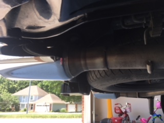

Hello,
I have the Mopar performance catback exhaust installed. It has about 6 years/60k on it (I pulled it off a 2012 when I bought my current 2014). It still sounds and looks great but, I'm just getting a little obsessive over the blacked out appearance and wondering if I can get some black tips to replace the chrome look? The current tips are welded. I'm assuming the pipe can be cut before the weld and a new black tip can be bolted on? It's a 2.5" inlet and I'd like to keep the 5" outlet. At the point of the weld, it's approx. 14.5" from the end of the tip. Anyone know of some black tips that'd work with this? I'm not a welder and I'm trying to avoid paying a shop for labor. Below is a pic of the current tip. Any feedback would be appreciated. Thank you.

I dont have the mopar exhaust, but I did just as you describe. I cut the factory belled tip off, then had new tips welded on. I've got the Carven 5" black tips

Thanks for the idea, I hadn't even thought about using the existing tips.........I took a quick look underneath, the pipes are welded into the muffler. However, it looks like there are some bolts/brackets on the exhaust above the axle that I'm hoping I can disconnect and take the pipes (plus welded tips) out from.
May I ask what you paid to have yours blasted & powdercoated? I'll call a shop or two around me of course, but just want to get an idea on what costs should be around. It'd clearly need to be cheaper than a new set of good tips ($200) to make sense. If more expensive than that, I'm back on my search to find some bolt on tips that would work.

Since the factory tips are welded on, I don't think there's any way to get direct fit tips that have a 5" in outlet with a 2.5" inlet. Your only option would be powder coating your existing ones or getting new tipes welded on.
