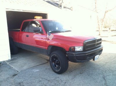

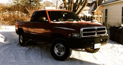

This is my truck I use it for landscaping and plowing (hence the orange light), as well as my personal vehicle. I am begginning to black it out. So far, I have done the bumper, rims, hubs, mirror housings, marker lights, tail lights, and my grill. In case you cant tell though I have terrible rust on my drivers side door and rear wheel wells. Besides get a new door / fender flares, is there anything I could do to cover this up / make it look any better? I also have 10% tint on the truck. Let me know what you think and what I should do next

Are you wanting to murder it out completely or black out the stuff that isn't red?
If you're doing the whole truck, either weld in our find someone who can weld in a piece of 18g sheetmetal after cutting out the rust and use body filler, self etching primer, match the paint, and clear it until you can get a full real paint job/body fix
It's fairly cheap to do but there's a ton of instructional vids on YouTube. If I could find someone who could weld in for me I'd do that this summer.
Edit: if you're leaving some red, have you thought about going black on the hood with the center section of it red? I think that would look badass. I just had to share that lol
