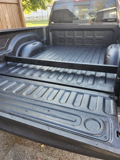

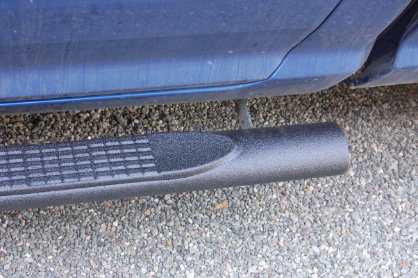

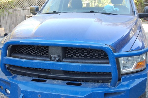

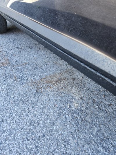

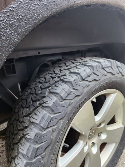

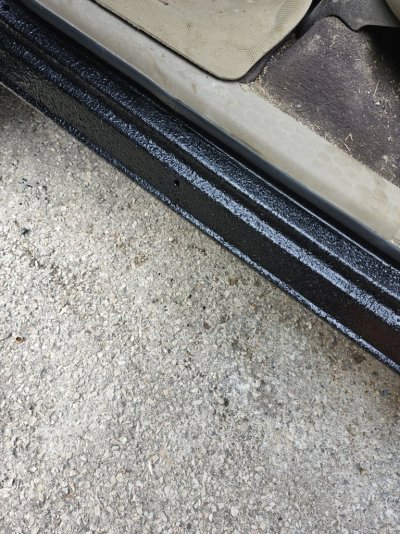

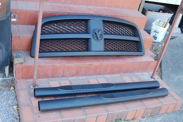

You did a great job on coating, some guys don't like that, I love it. I line'xd my grill, bars, bed. It held up perfect many years later, maybe a decade now, the powder coat has long failed, industrial coatings the way to go.

Looks good. Works well with the blue. I was back on forth on doing it. The passager door had some paint peel on the bottoms I had to take it that high. Went off the curve in the sheet metal. I that to paint it tan like the interior, would have work with the dark down. But durability was most important. Little fiberglass zero filler. Two coat of flat Grey metal paint first. First cut really thin with acetone to let in flow into everything. Then a slight cut with acetone for the second coat. I find the flat is better then gloss for good adhesive for the coating. I wasn't to fussy with the age of a truck. And the oem fender flare will cover what I coated around the wheel wells. Going to be ready happy one it is rust proofed and driving through the mucky salty mess. You steps bar look good I order new ones was thinking of coating them as well. Think I will order new fenders when I do the manifolds make it easier for the mechanic while the fenders are off. Will just put the flares on the rear for now if I do that.
