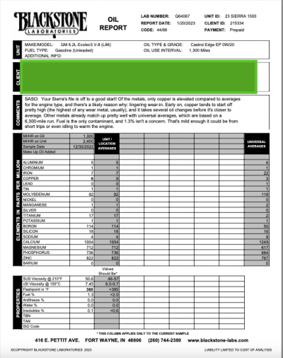

HERE YOU GO GUYS, this is only 1300 miles on a brand new motor total miles 2400 miles

Thanks for sharing - hint, prol'y want to remove your personal contact info for privacy.
Looks like a GDI engine owing to the unburned fuel dilution and matching lowered flash point. Gonna need to change that oil often!

I had a Hyundai Accent with the 1.6 GDI back in 15' as a scoot about for work. It was a great little car but the oil wreaked of fuel every oil change at 5,000Km's using synthetic oil.
The dilution in the GDI engines are pretty significant. I never did an oil analysis, but from experience and years past turning wrenches I knew I had to keep the oil change intervals tight to ensure trouble free longevity on the engine.

By the way I have right now valvoline ep oil in the truck this oil have a heavy load of molybdenum around 300ppm , at around 2k I will drain this oil and send a sample again, I want to see if a high moly oil will perform better on this push rod monster

Your truck is far too new to be running UOA's. I mean you can run them but you can't actually use any of the data for drawing conclusions one way or the other.
