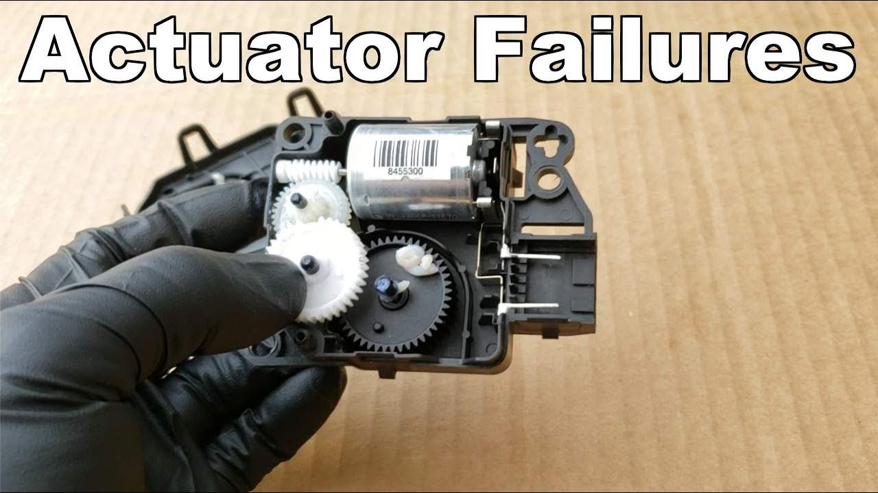

Chrysler MOPAR actuators are the strongest & best made
None of the others have Limit Switches
they can be calibrated by the owner
How the actuator actually works or fails
