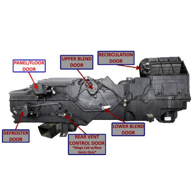

The first thing that I would do is connect my scan tool and go look at the HVAC control and verify that the controller is attempting to sweep the actuators. Then I would physically verify that the actuators are moving and that the blend doors, mode door and defrost door are moving freely as well as the recirc. actuator.
With that said you may want to recheck the evaporator by removing the blower motor and sticking a small mirror and a flashlight in the housing to look up at the evaporator.

I know it sounds simple but, did you check your cabin air filter to make sure it isn't plugged up. Even if the filter is clean, look inside the housing to see if it is plugged with leaves, mouse nest etc. Use a mirror and light. With the cabin air filter out, test the system. You should be able to see the blend doors move, which tells you the actuators are working and so are the doors.

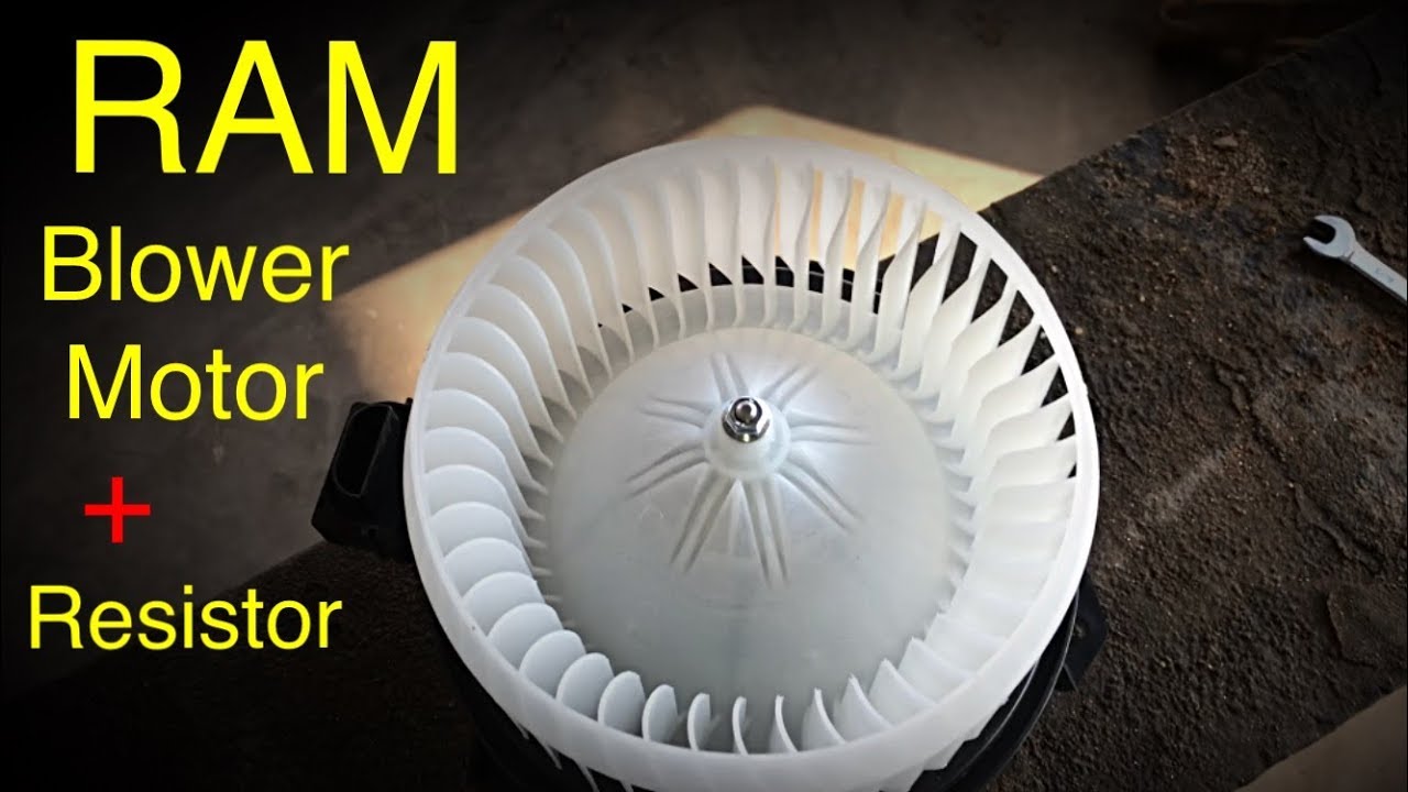

At 2:18 in the following video, the blower motor is dropped. You could inspect, clean and test the motor. Also, stick your hand, and/or a dental-type mirror into the opening to look for a mouse house or other miscellaneous debris.
An automotive version of a dental-style mirror is available at parts stores.
