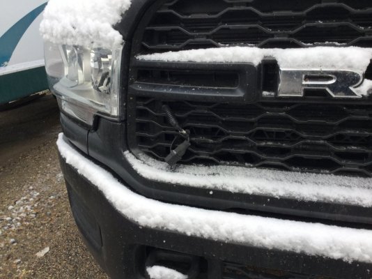

Like the others have said, find the actual male plug attached at the bumper. It is on the right front side, when sitting in the drivers seat, left side of center if you are looking at the grill. Attach a permanent extension cord to it, they aren't long enough to plug into the wall.

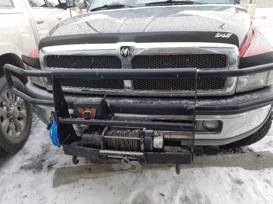

My 1996 and 2021 are setup exactly the same. You can see the cord wrapped on the holder on the winch bumper. Last picture is the extension cord holder, can be mounted to grill, bumper etc. Cost maybe 10 bucks.

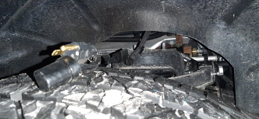

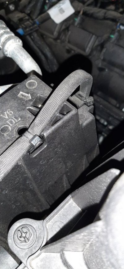

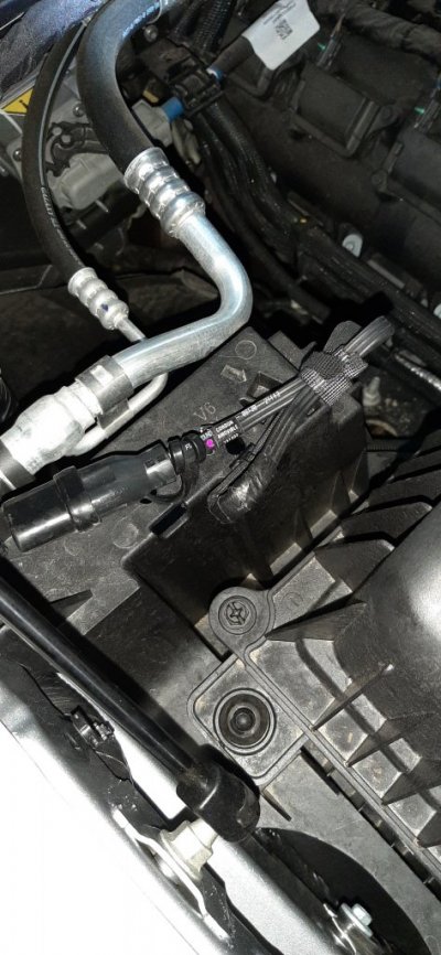

Rneck1 here, I've got a 2021 Laramie e torque 4x4. My block heater cord is about 18" long, after looking further I unclipped it from the mount and routed it out the driver side wheel well.

Good Pictures R1. I have to say, that is way past stunningly stupid on FCA's part. Having to pop the hood, deploy the plug and reach in over a dirty tire each time would suck. I think I would run a permanent 25' extension to that plug, zip tie it in place and run it out the front bumper, then put a cord holder on the front grill or Bumper.
