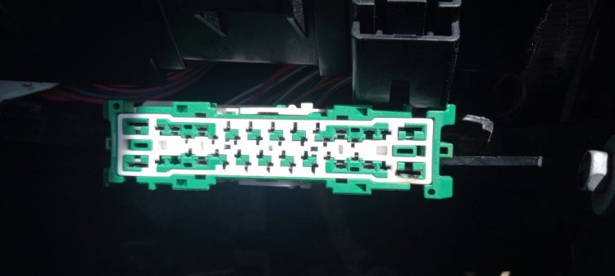

Fought this issue last summer. Replaced fuse, relay and blower motor. It was towards the end of summer and that seemed to fix it. Then this morning I get in my truck to go home and no air blowing. Rage.
The first damn Google search result was this video from 3 years ago: https://youtu.be/Yoz78FKnVZE
I don't know why I couldn't find it last year, but I went outside to check before going to work and this is exactly my problem. Tightened up the connector with a pick and drove to work with AC.
Here is what mine looks like right now. I have time at work tonight so I'm going to search for part numbers and order a new whatever that green thing is called.
I'm also going to post this YouTube link on a few other blower motor threads because when I was having the problem last year I didn't see anyone else post it.

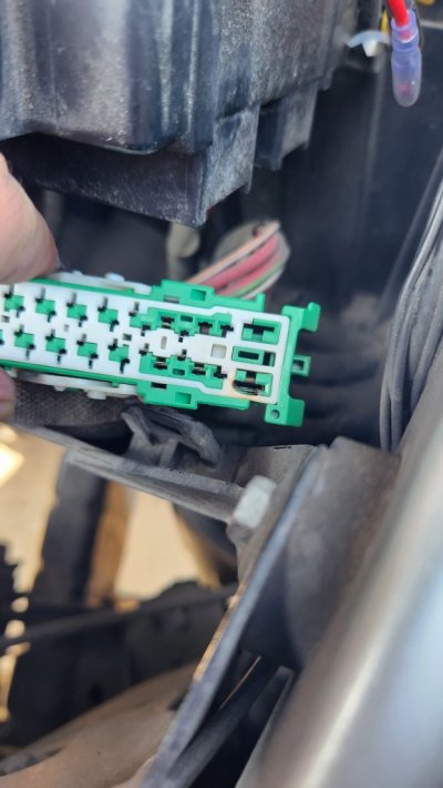

Thanks for posting. Just fixed same issue
