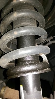

Blown shock 55,000 miles?
I noticed a few oil spots on the driveway so I decided to investigate...
Has anyonee else had to replace their shocks with similar mileage? Is this covered under warranty?

Damn that sucks. If you have an extended warranty they might cover it. If not, time for some Ranchos or Bilsteins:naughty:

I changed the factory shocks on a truck once that had 6 shocks, three of them would stick shut when we pushed them down after taking them off, that was 70k miles. You will like the ride you get with bils anyway, especially if you go for 5100's.

One of mine went just outside of warranty on my 2011. Cost like $200 for a new one
