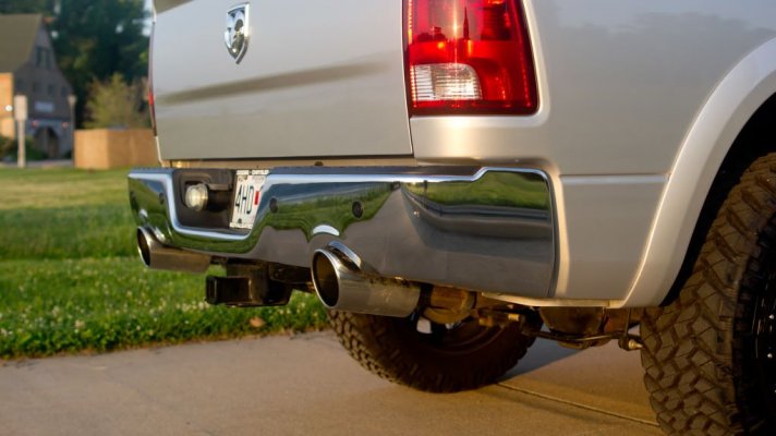

I adjusted mine at the tips. Looks dorky as ****, I'll get pics in the morning. :D
For a 3", it will probably need a lot more adjustment, more than you can get from the ball connection for the tips.

yes, the tips are dirty..........lol, whoops.
But, I think I need to pull 'em down a hair. They are really tucked up to the bumper, from the side you can see them running up. LOL

Weird, I didn't think about adjusting the tips like that. The angle of the tips doesn't look bad, and they are close to the bumper.
