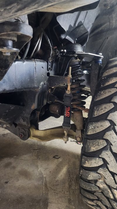

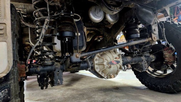

You can add the spacers but you will need to upgrade your front uca.I currently have 4.5 inch spacer on mine but I had to change my uca to jba and added a 2 inch ballpoint spacer. As for you adding a 3.5 inch spacer to the rear. You can but you will probably need to upgrade your control arms and sway bar end links to accommodate the extra lift. Will also need to upgrade the panhard bar to accommodate the lift. Attached some photos to give you an idea of what I did.

You could get away with a 3.5 inch spacer up front. Again gonna have to upgrade your uca. As for the rear. I have a 5 inch coil with a 3.5 inch spacer. So that's possible. Again gonna have to upgrade other components to do so. Unfortunately it will not be as simple as just slapping on spacers and that's it. And I won't lie many on this board are against stacking spacers and such. So take any advice I give with a grain of salt but I don't mind sharing how i built my truck.

It's a 2009 dodge ram 1500 4x4. It has a zone 6 inch lift with the 5 inch rear coils. It also has a 3 inch body lift. So suspension wise it's at around 11 inches of lift. But around 14 total lift with body lift.
Front: rc extended struts
4.5 spacer on struts
Jba uca with 2 inch ballpoint spacer
Extended travel cv axles
Rear: 3.5 inch spacer
Core 4x4 adjustable upper and lower
Control arms
Core 4x4 adjustable panhard bar
Core 4x4 sway bar ends(custom
made for this lift)
It currently has 24s on 37s running stock gear ratio but will be upgrading to 4.88 gear ratio and 40s.

i just started doing vids on TikTok. Yes the 6 inch struts plus the spacer on top. Yes the ballpoint spacer is to allow for the spacer and keep the uca at a decent angle. Yes, my kit had 5 inch rear coils then I added a 3.5 inch spacer. Yes 3.92 gears. Even if you stick to 37s I recommend 4.10 or maybe even 4.56. You will loose performance and gas milage plus the additional wear and tear from heavier tires. Feel free to direct message me on here for any questions you got. I'm by no means an expert but I have put alot of research into my truck. I don't mind helping.
