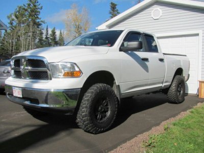

Do both.. Level kit and bl. I got 2.5inch level in front. 3inch bl. And a 1 1/4 rear spacer not installed.
Sent from my SGH-I747M using Tapatalk

White Beauty
Jun 17, 2013
1,227
314
Moncton, NB
2011 Ram 1500 SLT
That's close to what mine should sit like then and I like how you're truck sits. Did you install the BL?
My brother did the bl install for me as I was away. This pic doesn't have the rear spacer installed.

You got a kick ass brother. I need to find more info on doing a 3" BL. I'm decent at workin under the hood, but I've never lifted a body from the frame.

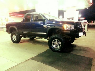

Yeah he's a licensed mechanic so it works out great. Hahaha. Said it took him around 4.5 hrs to install. Just gotta follow instructions he said. Can be done with Jacks and Jack stands just a lot more time consuming.
Here's his 08 with 37's. Modified 8 inch lift. He's made a lot of parts himself.

Cruizer
Sep 16, 2013
6,816
2,427
Ohio
2010 Sport 4x4 QC
That's a nice truck. I'm hoping to have a buddy or two to help speed it up. I'll have to use jack stands. Wish I had access to a lift.
