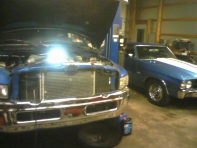

well finally fixed the issue, and i realized what is right away just took awhile to get the time to fix. well long story short after i bought the truck I hooked it up to the scanner and besides throwing codes at the o2 and everything i noticed the ETC temp on the scanner only read about 130-140 when running for 5-8 min. So I took the thermostat out and it was in pieces so replaced it and now the etc is running 180 in about 1-2min and no more bogging. now i just gotta let the air bleed out from the box and shes gonna be running :********:

yeah, i wish my fix was that easy! sexy SS btw...

thanks its my grandads, its stroked to a 383, ill get some engine pics sometime
