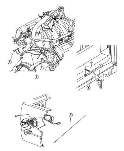

Check the grounds on the back side of both heads,alot of times they'll get missed on the reinstall

On my '15, the ground on drivers side head is at the rear, but the pasenger side is in the front.
I think both heads are exactly the same part, the have the same casting numbers. One is naturally reversed, though. I might be wrong about this, just things noticed while my heads are on the bench.

And that one goes to the firewall or frame?
On a 2012 Ram 1500 with the 5.7 Hemi, there is a ground strap located at the rear of the cylinder heads that
serves as a chassis-to-engine ground point to ensure stable sensor signals and consistent voltage, though its importance can be debated since most sensors are grounded through the PCM. You should ensure this strap is present, clean, and securely mounted to the cylinder heads, as poor grounding can lead to erratic sensor readings and potential engine issues.
Location and Function
  • Position: The ground strap is located at the rear of the cylinder heads, connecting them to the chassis.
  • Purpose: It provides an alternative chassis-to-engine ground path, which helps in maintaining stable electrical signals from sensors and other engine components.

You can not have more ground connections than necessary.
With the age of your truck ,every ground is suspect.
Keep an eye on major harness connections, the pins can be pushed from their locked position .
Look at the big harness under the driver side wheel well, it has a large connector that’s prone to crusties.

You can't have too many grounds. Some of the so called grounds are actually "bonding" cables that help prevent electrolysis between the aluminum and steel components, especially when winter salt is added. Very real problem in modern, multi material vehicles (like boats, too).
Some of those straps also prevent stray RF signals, that mess up the electronics, in some cases.

I can attest to that,my truck had more extra grounds run then Carter has pills,lol. I had issues with the tailgate not unlocking when the truck was brand new,and running extra grounds cured that issue,and in the 10 years i owned the truck,it never had any electrical issues except one that was self caused when i wasn't careful reconnecting the throttle body and slightly dislodged one of the pins in the connector
