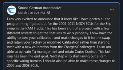

If I could pick anything it'd be an SRT10 or a 2014 Hemi, pure and simple. Thanks for the insight, dude. Kinda sad, as I want 400-500 wheel, but oh well. If anything it's just more money and work regardless. The 3rd gens have the problem of needing a trans swap, so it's not all bad.
It's becoming seriously easier to do that nowadays.

While it is becoming increasingly easier to retrofit the ZF, the advantage of a 14 or newer is the ability to just drop in a factory 392. That's almost 500hp stock with cylinder head capability of much more even without boost.

Well, the ZF has an unholy first gear, but according to the Canadian running around in a 2004 QC with a 6.1 based 392, 8HP70 & 4.56's says the extra gearing isn't bad at all. Me personally, unless you're really need the towing oomph or just really like short range acceleration, 3.55 would probably be the best all around gear with the ZF.
