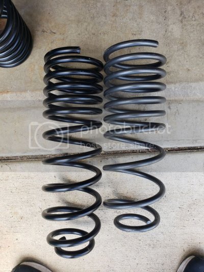

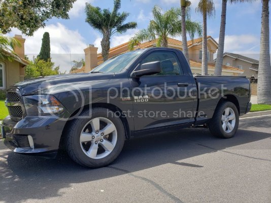

You may just be too low. I'm having the same issues with bottoming out now that I added the Inez no cut brackets. Now that the axles is corrected, the upper control arm mounts are hitting the frame.
I measured from hub center to fender and came up with 18.5" in the rear. Stock measurement was 23-23.5" in the rear. I knew the rear looked a little low. Totally of 5" drop with about 100lbs of work gear in the bed.
The solution for me was to get the "cut" relocation brackets or to raise the rear up a little. Luckily for me, my dads coworker gave him a set of 2" drop springs. Not sure of the make but they are black and just say 2" rear drop on them, they were also thicker and hard to compress vs the belltechs. I threw them on a little early and it brought the rear end back up to 22.5" lol That's with a full tank of gas and work gear. After dinner I'll cut a full coil off and work from there to get me down to 20". That extra 1.5" of height/travel should really help out.
This is the results with the 2" drop spring... way too damn high lol
I'll post again with measurements and results after

Ah ok. Well I hope you get it resolved. I have the 2" drop rears on and cut two coils off them. Still too high for my liking lol But on a good note, it rides night and day better. I think I need at least one more coil to get me to 1" rake front to rear with a full tank of gas and work gear in bed.
