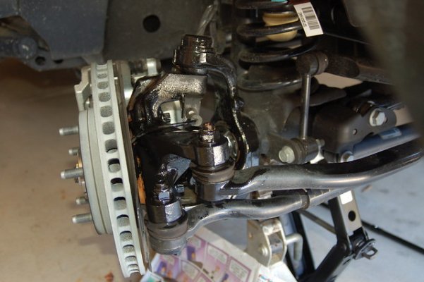

They have rust paint just for suspensions, the reason it is for suspensions is because they don't do great in the sun shine, nothing better then suspension rust paints, you just paint over the rust. You may want to wash the salt off with some ramps, then use por 15 or chassis saver. POR15 a little easier to worth with, goes on like cream cheese a little thinner then that but similar, chassis saver more like water, pretty thin. But both work perfect. Both make your old rust part of the coating, no lie. Great for your world, if it is on the salt belt I'd rather fluid film it, but for the sun belt por15 way to go. Maybe rustoleum type product is easier with a spray, but it wont have the same coat. I'd buy a sample size por15 they sell that and compare.

I now see por15 also has spray cans, this is newer, something to check out. They also have a metal conditioner for any paint you use, something else to like into with the salt factor.
My old heap..
Looks Great, I used POR15 on my 64 hot rod truck project in the past, never really thought about it on a new truck!
