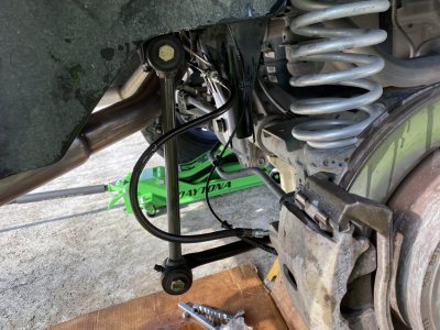

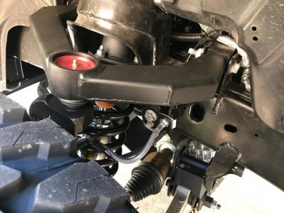

Just got mine in. Ordered the full set. Ordered my front 3” longer which may be 1” to long but I’ll deal with it. Rear I ordered 2” longer and that’s a perfect fit. I’m running 1” longer shocks and taller springs. I plan on installing Kings which I think allows for slightly more down travel than Bilstein 5100s. And my rear is 1” lifted with longer shocks. It wasn’t really pulling the back cables but figured why not. The front cables get a bit of tension at full droop though with my 1/2” top spacers

remind me next time brake lines have to be done to bring it in to a shop... the rear is a pain in the butt. I did it but it was not fun. Still have to do the fronts but it’s getting dark. No discernible difference with just the backs. I did learn however that if I floor the brake pedal and hit the gas pedal I can overpower my brakes. I know that happens in 4wd low anyways.
