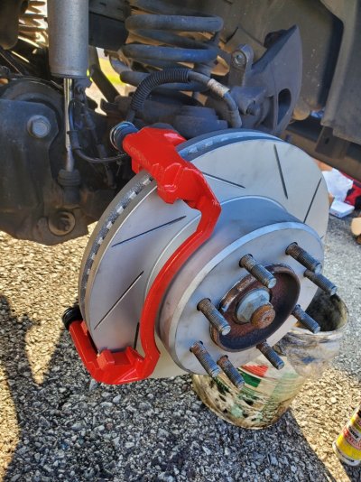

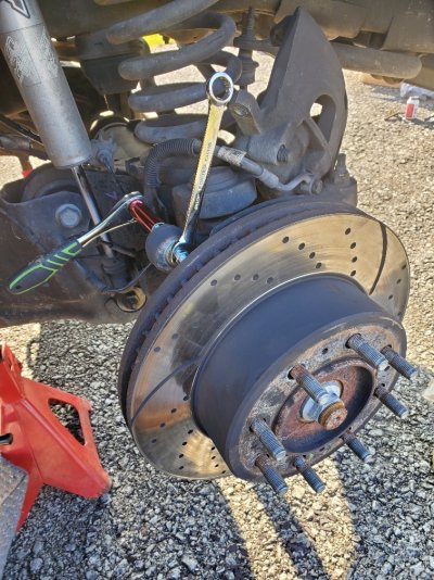

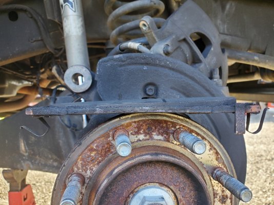

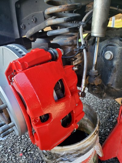

In a sad turn of events, R1 Concepts was not able to create a BBK and still let me run my 18" Method wheels. I would have had to run spacers which I did not want to do.

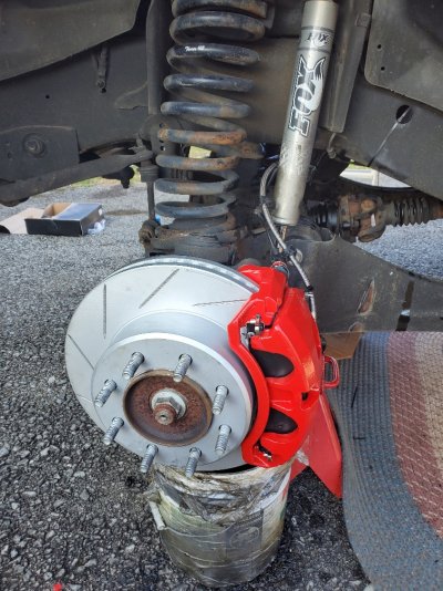

@Nick@GotExhaust worked with me and we came up with the best solution he had available. Went with the Power Stop red powder coated calipers, Centric Posi-Quiet brake pads, R1 Concepts slotted and coated rotors and stainless steel braided brake lines.

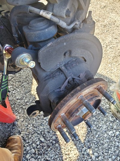

All in all the install was as expected. I did the brakes on this truck 2 years ago and put anti seize where needed so I didn't have much difficulty. The EBC rotors were still in pretty good shape. The pads on the right side were shot and wearing very unevenly. You can see that in the pics.

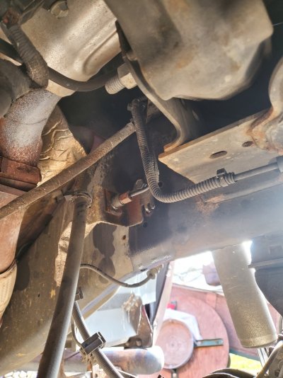

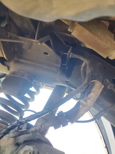

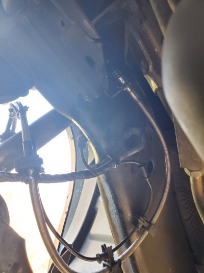

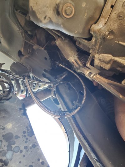

The stainless lines went in fairly easy. Soaked the original fittings and it came right apart. The new lines are nice and fit well. I reused the clamps where able and just used tie wraps where needed. The rotors are well made although there was some chatter in the slot cuts. Shouldn't matter in use but I thought it was noteworthy. It was difficult to get a good pic of that so maybe I'm too critical.
I haven't driven it much yet so I don't have any review just yet. I'll report back after a few days of driving.
Here are the pics. I'm uploading from my phone on Tapatalk so they may be out of order but I'll do my best. Let me know if anyone has any questions. Thanks for the help in piecing this brake kit together, Nick. I would recommend buying off of him to other members here. 5ab24e91f52ab3ad1bfad4cbaa0dc649.jpg86a9ba45a6c3db9f9c5932fee8128096.jpgdf52348910b295d50f53f68af5dbacbd.jpg2f3497977a120f484dba977489f3d0c6.jpgcc6d916bf624889ccacaca24a1a0058f.jpg1d7a925c8d859078b4013a0d2a89881f.jpg6bfe2beeeff31b464d1086d84dd1e921.jpgb6d96e22c4c7d3717dca1ef8cfb5cb11.jpge3adee69d57353821c54d4cc1e86480d.jpg50910bd113f02cb81198b4c232cd915c.jpgc76fdb966736b2eeba50ea1536657760.jpgeb951dfd96ad4684d9210d588674a2a7.jpg46d601f1ce8fea5b1f7b1755c0acbd62.jpge745f53932c8bdc8470a4cebc319d5bc.jpg5efd1ea94a1b6a5210ed45dbe0532abc.jpg
Sent from my SM-N975U using Tapatalk

Thank you for sharing. Install looks great. pretty crazy how un-even those pads were wearing! Definitely a good move replacing the calipers as they were most likely the culprit.
