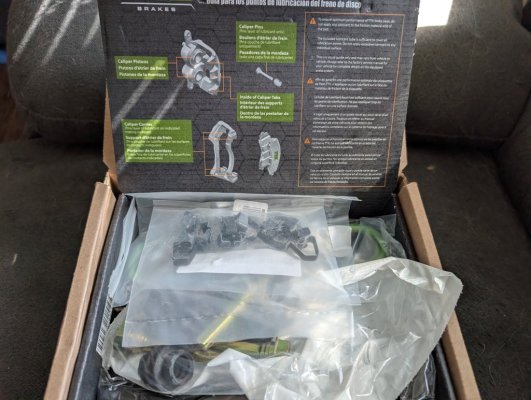

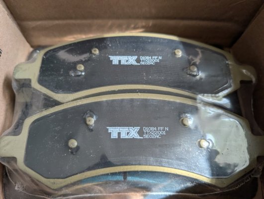

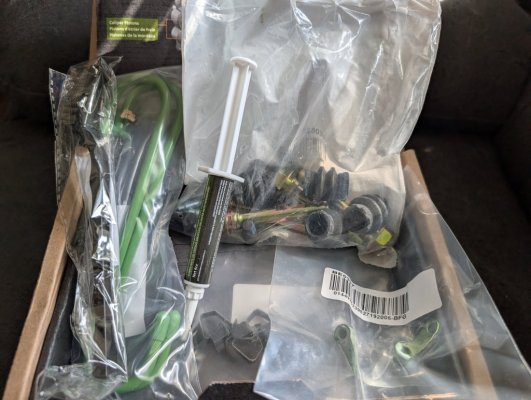

Getting ready to do brakes on my 19 classic again. I'm not happy with the stopping power/performance. They're underwhelming at best. They've been on the truck over 2 years now and it's just time. Powerstop is almost always the top recommendation, and for good reason. But, I saw these pads when browsing rockauto and they caught my attention. Mevotech, specifically their TTX line, has usually been pretty solid. Then I saw these had a brake in coating on the pads similar to EBC. (EBC Green stuff pads were some of the best pads I've ever ran on a vehicle). Plus, you look at everything they give you in the kit, caliper hangers, a tube of lube, new bleeders, all brand new hardware. Literally everything you need to rebuild the calipers besides the pistons and the seals. So, I ordered their premium metallic pads, which are their mid-tier pads. I don't tow a lot, I don't haul a lot of heavy stuff. Seemed like a good balance. So I ordered them and power stop OE replacement rotors (I have drilled and slotted currently and I'm over it). In the rear,no went with a set of centric pads and rotors. Figured the fronts are the most important since they do most of the work. But, centric makes decent stuff at decent prices.
Ordered yesterday morning, came in today. 110lbs of brake parts according to rockauto. Opened up the mevotech pads. They look great. The pads themselves are HEAVY! I was supposed to be working on my ex's van this weekend, but USPS dropped the ball on getting the oil pressure switch here today, so guess I'm putting brakes on my truck instead.

Update on the mevotech pads:
They suck. Hitting the brakes felt more like a suggestion. Just installed a set of bendix fleet Metlocks and it's a night and day difference. Pads actually bite and grab. And the harder I press the harder it wants to brake. Plus, they were only $25.
