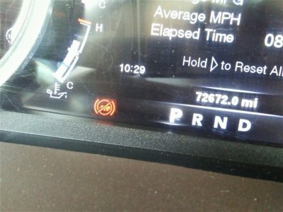

So still trying to wring out my TT brake problem. I have isolated the problem to the truck. While testing the wiring my truck gave this error message. Is there a common fix for this? If not can the pitiful dealers figure it out? Should this throw a code?
This all began with my last trip. With 2700 miles to get home my trailer brakes stopped working and just showed no trailer connected. Once in a great while they would work but with reduced braking. After days of testing this light came up on the dash.

Not a Ram but I had a Chevy with an integrated brake controller that would occasionally flash a “service trailer brake” message. Fix was to take apart the 7 pin plug, clean all the trash out of it, and then lube with dialectic grease. The Chevy was about the same age as your Ram was and the 7 pin was pretty nasty inside.
With your symptoms of intermittent issues my suspicion it’s a bad connection and the plug is a good place to start since it sees the most wear and tear from both plugging trailers in and the elements.
Thanks- I'll give it a shot.
