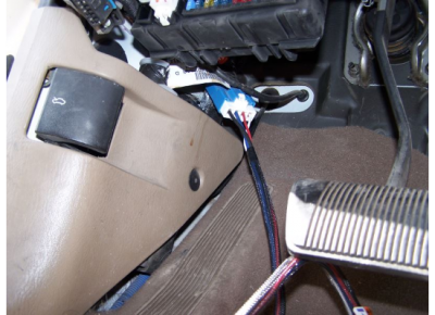

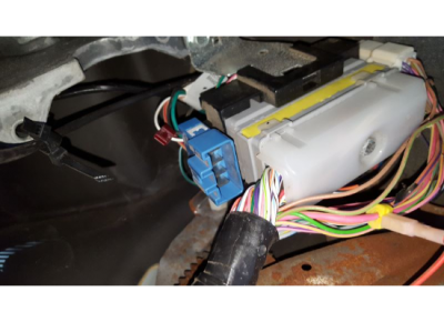

The connector should be between the emergency brake pedal and the steering column. It looks like the below. You will need a wiring adapter like the Teknosha 3030-P for your truck. The adapter is the white piece in the pictures, the blue piece is part of the truck. Sometimes the factory like to hide them so look behind harnesses or brackets.

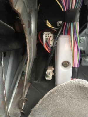

Thanks for the reply
Here are some pics under the dash
If you have the factory 7Way plug in the back, this is what you need. If not e-trailer has that also.

I still haven't located the connection for the controller.
Is it the grey piece in the picture with the fuse on the end?
