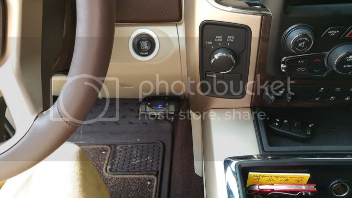

Are you guys going with aftermarket controllers mounting them in the standard kick panel location? I had a P3 in a previous truck but with long legs it was always getting bumped and just in the way.
Here is where I mounted my P2, I'm tall, 6' 4" and my knee/lower leg bumps the P2 on entry/exit. I don't like it here but couldn't find another location. Suggestions...(besides getting Chrysler to fix the issue).
Update: P3 installed, i just had to disconnect the one plug like boss hog said, have not hooked up to camper yet to try it, also Ram customer service called me back yesterday to ask if I made another appointment and offered a rental car for free if I need it, sounds like they are starting to listen to people a little, next appointment is monday.
Let's see, 50 plus page discussion here, every RAM and RAM Cummins forum I've been on has two or more threads running about the ITBM turning off the trailer brakes under 30 MPH, the icing, Tekonsha designs and builds an interface cable between their Prodigy brake controllers and RAM's factory ITBM connector. To add insult, webs sites are sell the P3/3024-P cable combination. You would think Ram would be beyond listening and taking action.
I mounted mine in the center console up by the dash where your keys are laying. Worked great and didn't have to lean over to use it.
Could you possibly post a picture? I'm having trouble visualizing the mounting and access to the manual brake control.
