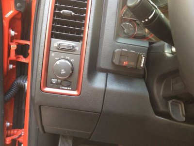

Solved my "do I buy it or wait until someone proves it works" dilemma.
attachment.php
attachment.php
attachment.php
Around $500 in parts/install (even if I self install it, best local price to just code it matched best install price.) for the "maybe it works" factory controller....well. $100 to hopkins instead of ram.
Wish Tekonsha had a P2 or P3 with a compact separate modular interface and a main module that didn't need to be horizontal to the truck.... (because in a bucket truck, your options for horizontal are limited..)
Wish the Hopkins InSight was more compact (maybe a single piece display/control. but at least a smaller manual control..), too. but done.
